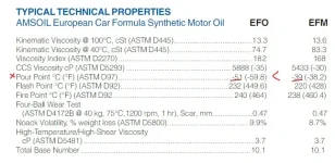

Maybe this is why...
With the specs he posted you can be certain the EFO has a decent slug of PAO in it, whereas the EFM is likely largely Grp III. Not necessarily a bad thing depending on your needs but PAO does cost more.
