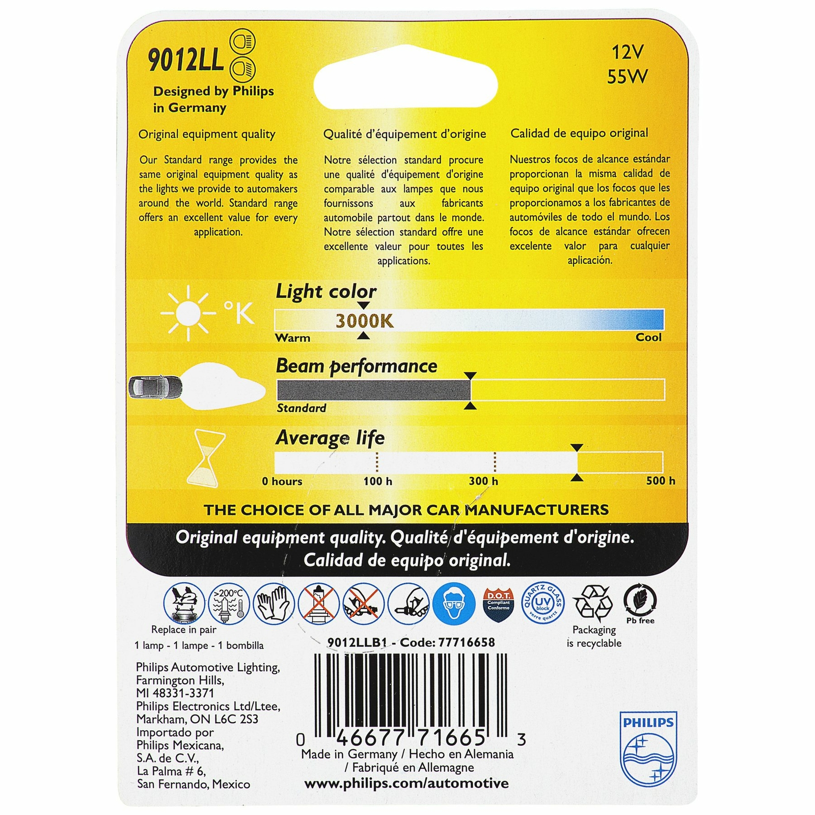

I changed the bad bulb w/another Philips 9012LL and all is well again. Comparing the new vs old boxes, there are some notable changes:
OLD:
[Linked Image from i.ebayimg.com]
NEW:
[Linked Image]
The extra ~200K explains why the new bulb is slightly whiter than the 2 yr old bulb on the driver's side. Perhaps it will color shift over time and become more yellow. But, I'm curious about the drastic change in lifespan. What could have Philips changed?
The 9012 Sylvania XtraVisions I put in place of the 9006 bulbs in my Burb have a lifespan of 150hrs so by comparison your bulbs have an excellent lifespan.
I think 2 years is reasonable for a headlight bulb, not sure why you are so concerned about it?
