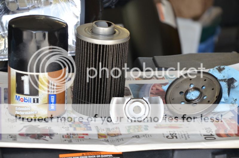

I've now run my OCI's out to 20K twice. Both with 15w40 conventional oils. The first with Delo the second with John Deere Plus 50II. I changed out the OEM filter at 20K and the by-pass filter at 40K. My by-pass filter was still working (hot to the touch. I also cut open both of my latest filters (Mobil 1 & Amsoil) and the elements looked good. I have pictures.

Hi, thanks for posting these results. Can you post your pictures of the EaBp 100 cut open please. Thanks Harling
I'd be glad to attach a picture of the Amsoil filter after 40K but I can't locate the icon for doing so!

Dual Gard:)
I would put a guard over those filters. You don't want a big rock to put a pinhole leak in them from the tires.
Pleated bypass filter? No more dense media, stack plates, compressed paper, TP or PT rolls.... So sad.
I wish that Amsoil would offer the "BE" filters again. Let the consumer decide which is better.
No reason not to go 25k on the oil and 50k on the Amsoil, as long as there was flow thru that bypass element.
