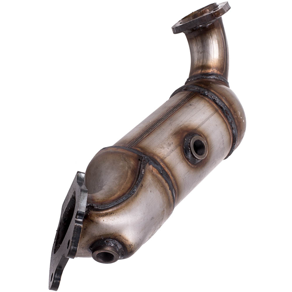

Like said above, there's no exhaust manifolds on pentastars. The CCs bolt right to the cylinder heads. I haven't seen any catalyst inefficiency codes for pentastars yet. Can you hear any undue exhaust sounds?

The upstream and downstream sensors are basically built right into the cat. What you see is bolted directly to the cylinder head on pentastars.
We have seen many efficiency codes on pentastars. New cat with new o2s is the repair
seem em broken. Likely many are cracked as well that is not visual. Worse one was the entire element inside was missing
