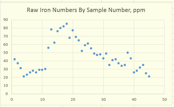

UOA at 7422 miles on the Mobil 1 TDT 5W40. Note the viscosity still at 12.23, down from 12.34 - it essentially didn't shear from 4000 miles to 7422 miles. Iron is average around 4.5 ppm per 1000 miles (I think that is pretty good for my engine and for 6.0's in general).
The old CJ-4 formula M1 TDT and Delvac ESP showed the lowest metal wear numbers in my VW 1.9 ALH TDIs.
Interestingly enough, a 6.0L owner on another forum posted that the newer CK version of Delvac 1 did not hold its viscosity NEARLY as well as what I have experienced with the older CJ version.

Just got my 245k mile results back. Around 16.5 month run period on this oil.
Mobil Delvac 1 ESP 5W-40: 3-1/2 qts CJ4, and 2.5 gal CK4 (MIX)
4/27/2024​
Date:
4967 milesParameter:
3
Aluminum​
1
Chromium​
21
Iron​
1
Copper​
1
Lead​
Tin​
34
Molybdenum​
Nickel​
Manganese​
Silver​
Titanium​
5
Potassium​
88
Boron​
5
Silicon​
2
Sodium​
1107
Calcuim​
979
Magnesium​
1037
Phosphorous​
1207
Zinc​
63
SUS vis at 210 F​
11.07
cSt at 100 C​
450
Flashpoint​
<0.5
Fuel​
Antifreeze​
Water (Karl Fischer)​
0.2
Insolubles​
7.5
TBN​
You have consistently good results here. How's the beast running?
I absolutely love the M1 5W-40 oils, as they are some of the best oils mankind has ever produced.
I am only driving about 4k miles a year now, but this 6.0L has been the best truck I have ever owned (and I have had a 6.9L and a 7.3L).
I still love driving it. It is running VERY well. I did just have to drop the fuel tank and remove the crumbled pickup tube foot. Oh well. I put a Bean's micro sump in it and all is well.
I also love the M1 5W40 oils - both the Delvac 1 and the Mobil 1 TDT.
The oil mix didn't seem to throw off the additives too much from your 240k Delvac 1 ESP run. It did end with a bit lower visc. than the previous run. Any towing this round? Always a good sign when our 6.0L shows 0 antifreeze. Wear seems inline with previous sample.
No towing this round. No "grocery runs" either. When I used it, it was almost always on the road for 25 miles minimum. Minimal idle time.
