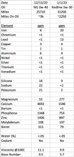

2 year update. The column on the right is Redline 5w30 which I've been running for the last two oil changes. It's good to see the engine is staying healthy. There were definitely some questions regarding my initial UOA with Mobil 1 since the additive pack differs fairly significantly from other M1 samples. The hot valve clatter that I had with Mobil 1 is gone with the Redline but the UOA doesn't seem very different in terms of wear metals... less Si, Na, K but more Fe and Pb. I honestly don't see much of a benefit to continue using Redline in this engine based on the used oil analysis and the significant price difference. The low TBN of the Redline confirms that this oil is not meant for extended drain intervals.
Lead is not good. I think this engine has a bearing issue.

Looks good. More quieter is more better.
