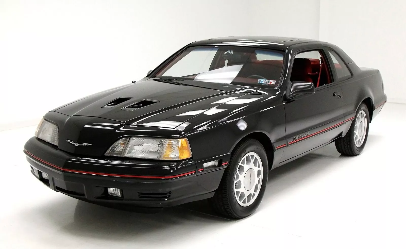

I remember Dad looking far and wide for Valvoline Turbo-V oil for his '85 Turbo Coupe....and being rather mad when I lifted a few quarts (in cans!) to top up my leaky Tr6.
What weights were recommended originally? Not knowing any specifics, Redline 0w or 5w-40 comes to mind as a quality oil w/ adequate additive levels, etc.
Pics of whatever you have please.
