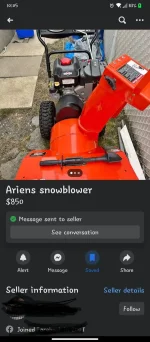

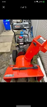

I'm shopping Facebook marketplace and Kijiji (like Craigslist for Canada). The Ariens 24 deluxe for 850 looks like a good deal but I'd bet it sold yesterday.

that ariens in your pic was sold from a small shop in Cornwall On
