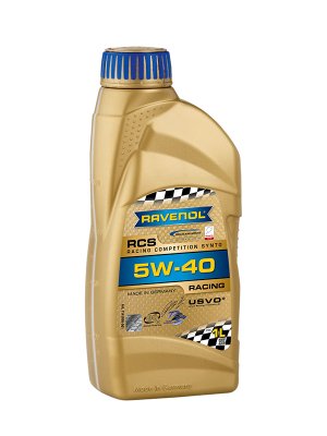

Last not least, did you consider these? Redline-like base oil quality (PAO and Esters), excellent
additive packs and oustanding data along with the most reputable approvals (except RCS):
My take are REP and RUP (mid SAPS, IMHO ideal for DI turbos). RSP and RCS are high/full SAPS.

5. I don't think I have a ravenol oil dealership in my country. As for the low/mid saps I read that for Di engines are preferred as they have less ash/phosphorus = less carbon built on the vavles , I think miller 5w40 CFS nt oil that I was using is a full saps ,that's why am looking for an alternative with similar specs (ester/nano drive) but mid saps oil so that it will contain less ash/phosphorus amounts.
