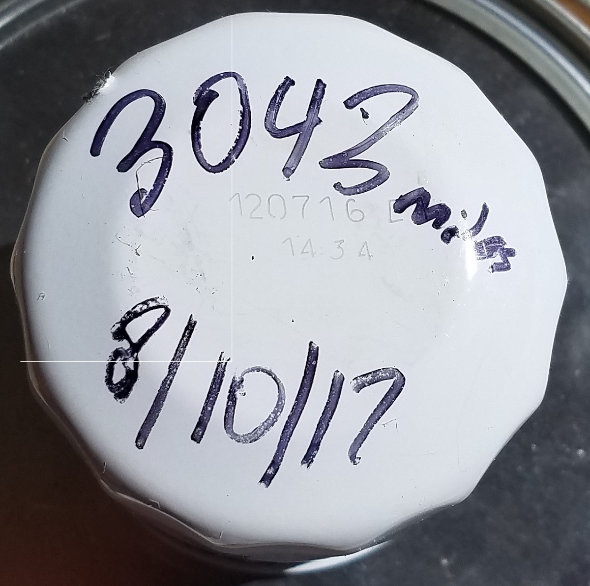

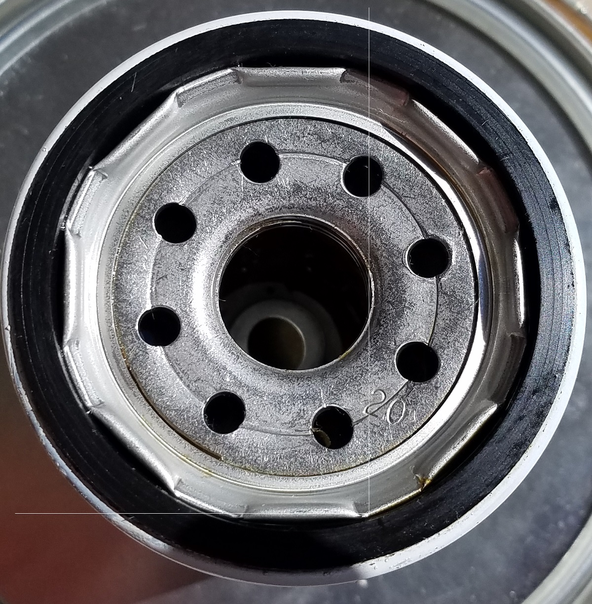

Ran this for close to 5K miles on my Frontier using Pennzoil Ultra 10W-30. Seems to have held up fine. ADBV is pliable and media looks decent. Hole in dome end was from me pre-draining it before removal. Replaced with a Mahle OC 707 filter and Pennzoil Ultra 5W-30.

As long as you realize the Super Tech 9688 application is a downsized/consolidated application from a standard 9688 application used by Hyn/Kia. In the Super Tech it's really the 7317/14610/57356 size. That said, still likely fine for ~5k mi oci for which the ST is intended. This ST9688 looks very good at 5k miles. This application and the other popular application ST3614 both use separate dome bypass too, a plus imo. Thanks for c&p.
Originally Posted By: Pajero
What is the red like substance? Respectfully, Pajero!
Adhesive residue
