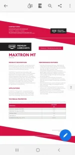

On the prairies I would give this a try. Locally made SAE 50.
