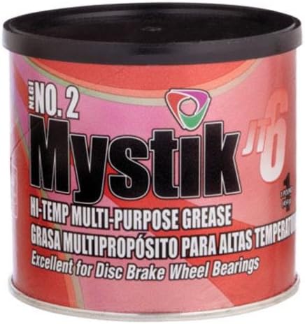

I can tell you that it's all I use. When I got my truck (used with no known history) a few weeks later it burned up a wheel bearing. I fixed it on a sunday. I had to source bearings and races from several places to make up enough parts to replace the damaged bearings. Most from china. Iirc one race was made in argentina.
They have been in there for 60,000 miles with no issues. I am sold on that grease.
