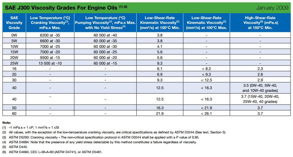

Originally Posted by CT8
The 10w-30 is good to - 17c starting temps and the 30 part is fine
? 10w-30 is good down to -25C as per the CCS temp. It has to pump at -30C (MRV).
Better yet the viscosity chart I have puts the 10w at 0*f.
J300 is in Celsius though wink [Linked Image]
