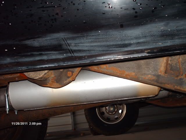

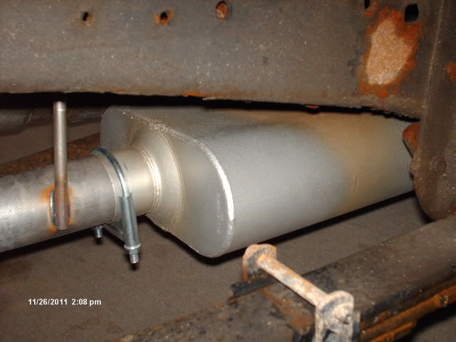

I got the Flowmaster system installed today and I'm happy with the results. Not too loud but you know it it there. Here are some [censored] pics. I also installed a new Delco O2 sensor in one of the inlet pipes on the new muffler since you were supposed to use your old one but I knew it would be rusted in and I was right. We later tried taking the old sensor out with no luck. Muffler shop only charged me $60 to install the system. I might add that I must have gotten very lucky on the price of this system because it is now $285 on amazon instead of the $160 shipped that I paid on the 19th of this month. Wayne
stain less steel. and anti-seize compound on threads on the bottom, and in the pipe connection. most stainless bolts is a different alloy than the nuts, they will bind as they are put together.

I plan on painting the welds. It rained all day today and the truck was all wet underneath and is why I didn't get a chance to do it yet. The truck only has 104,200 miles on it and spending $160 + $60 for the install is not very expensive in my opinion. The muffler needed to be replaced and all of the mufflers I could find for this truck were $120 or more so I considered $160 for the entire cat-back a deal. Wayne
