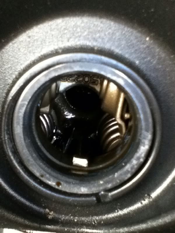

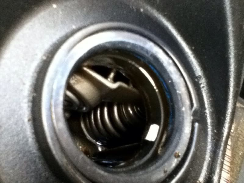

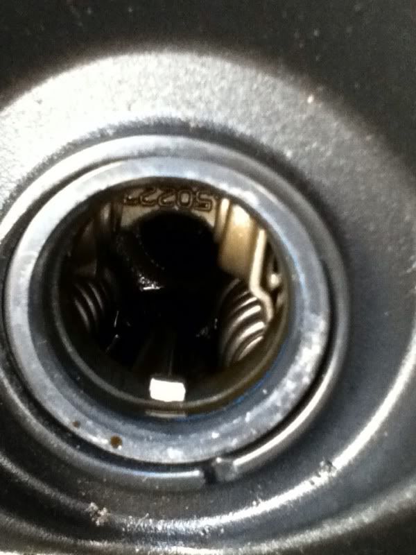

This is for my 06 with the 3800 series engine, supercharged if that matters, I drive about 25 min. to work all highway with a few lights. I typically drive with a light foot for the most part, there are time when I like to get on it. The cap says 5w-30 so ill be using that. It can be regular or synthetic oil, just something I can go pick up at the store. Also how much oil does the car take? Here are the pics and the mess that Im dealing with wink

That looks pretty clean actually. I recommend the taller Pureone filter and Pennzoil Platinum 5w30. I have used PYB, PP, PU, Rotella T5, T6. It really isn't picky. BTW: if the 24011 doesn't fit. It is because it needs a motor mount and yours is beat. Just a FYI.
