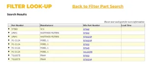

Usually use Rockauto to get the part number but got confused as their calling for the same exact filter of my old 08 Sierra 5.3 and (Fram 10575 which was also the fram number for my 2013 SRX) - Rock Auto both listed the WIX filter WL10255 for my 2013 SRX and 2012 Impala. They all list the same exact mobile 1 filter between all the makes. I did cross the numbers on WIX website and got a few different numbers. Checking all the vehicles at Napa showed all the same Napa Gold number. I just got nervous that Rock Auto isn't listing the WIX number and would rather not pay more for Fram filters than I did for Wix filters just 6 months ago.
