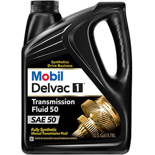

Would 80w90 GL-5 work? If not, why not?
The Caterpillar drive train (TO-4), SAE 50 engine oil and CD 50s mentioned above are non EP GL-3s.
The question is always: Is it safe to use GL-5 when GL-4 is recommended, even if the GL-5 states that it is buffered to be yellow metal safe. The answer you choose to believe depends on how much you trust the product labels and anecdotal stories. One wonders if the equipment manufacturer recommended GL-4 for the yellow metal concern, or if the specification is just old and obsolete. How much risk is one willing to accept? Many people ignore the mfg. recommendations. Others are just the opposite.
