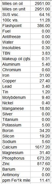

Impressive flash point for the fuel content. Impressive fuel content for the service and engine design.
Perhaps all direct injection engines are not created equal.
Nice job of starting trending early! This car should last a long time with this kind of attention to detail.
It's interesting that Manganese is lower than the FSI FF UOAs while fuel is 1% and FP is high. But that is comparing 2 different engines and FF no less so it's just curiosity and speculation for fun.
For fun, here are the averages for the 5 FF runs for the 2.0 FSI. Note that Manganese is much higher. Zinc, P, and Ca numbers are different also. So looks like a different FF than used in the 2.0 FSI (note that the The Zinc, Phos, and Calcium numbers were all very close between the 5 2.0 FF UOAS).

How can TBN be at 3.8 for an average 3k run?
Were some reports lacking a TBN and the result got skewed?
Maybe it's just the low saps situation.
Here are the numbers. Low SAPs could help explain the low TBN as could fuel dilution.
3807 miles TBN 2.6
5000 miles TBN 3.7
2208 miles TBN 5.2
2810 miles TBN No data
930 miles TBN No data
I have to correct myself, this UOA is not a low saps oil, whereas the averaged UOAs seems to be.
This one is Z 1200, P 829 and the average one is Z 817 and P 673.
That's a big difference. Syntec 5w-40 is only Z 1000 / P 1000, and Rotella tops out at Z 1200.
The low saps oils I can think of are more like Z 700 / P 600, iirc.
So, this FF oil seems to be "improved" over the others, if one can say that.
It makes me wary of low saps in this engine, if the FF is not one.
