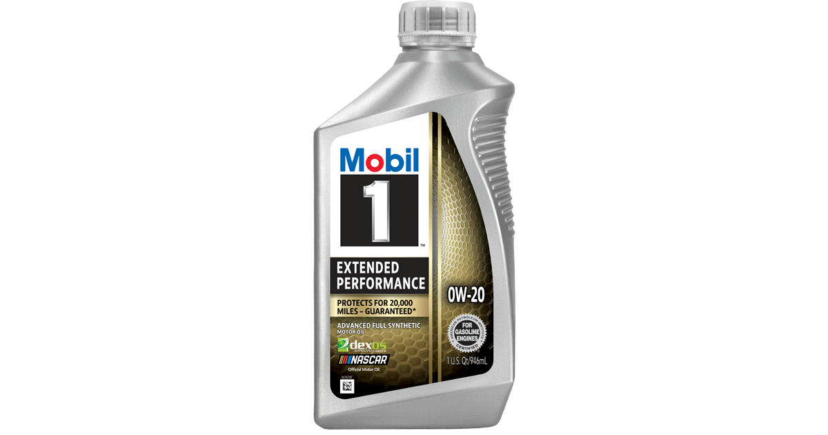

Which one is better for a turbo DI engine pushing 20+ PSI? Why?
Both are SN+, both are Dexos 1 G2, both are GF6A

The length of the OCI would be the deciding factor for me. If below 10,000 OCI, I would pick the Valvoline EP. It has a great add pack and that 300ppm of moly would keep it nice and quiet at that 20wt. The Mobil 1 EP 0w20 was super loud in my Toyota Tundra. Now, if if over 10,000, I would go with the Mobil 1 and just ignore the loudness LOL.
I am using the 5w30 Mobil 1 EP currently and it isn't loud like the 0w20 was...but this is a differnt engine as well, so...
