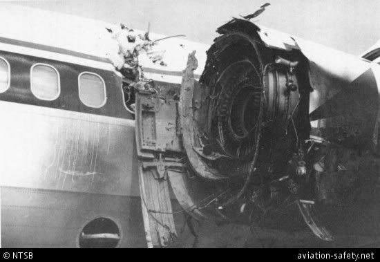

What failed on that engine?
it is very difficult for an engine to throw parts out of the cases with enough velocity to cause damage to the passenger compartment.
I used to stand next to the engines while they were on the test stand. it's fun to check for leaks with a 10' prop spinning next to you.
I can't find any facts concerning the picture I posted...perhaps a turbine blade?
Something similar happened with a Delta MD88 in Pensacola in 1996. I used to have a picture of the Pensacola plane but can't find it now. It put a sizeable hole in the fuselage, but thankfully the takeoff roll had just begun.
"Uncontained engine debris from the front compressor front hub (fan hub) penetrated the left aft fuselage. Two passengers were killed and two others were seriously injured." --NTSB.ORG
I recall reading elsewhere that a piece of the blade was located embedded in the first aid kit mounted to the wall inside the plane. Scary stuff.
