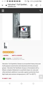

Lucas grease is one of the things Lucas makes that is good stuff. But I can't find a min temp for the xtra hd whatever green tube.
22,677
Apple Valley, California
How about this?

If your only looking at occasional Sub-Zero temps then a normal #2 grease will work fine. The bearings will be a bit stiff to start but will warm up fairly quickly once moving. Damage will be negligible.
If your looking at operation in Sub-Zero temps all the time I'd use a #1 grease or a full synthetic grease.
That's all for ~-10 or so if you're talking say -30 then first suggestion is to move second is definitely use a full syn grease.
