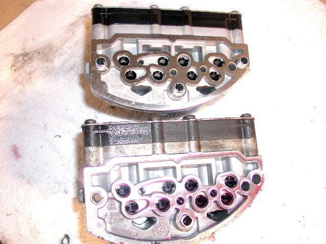

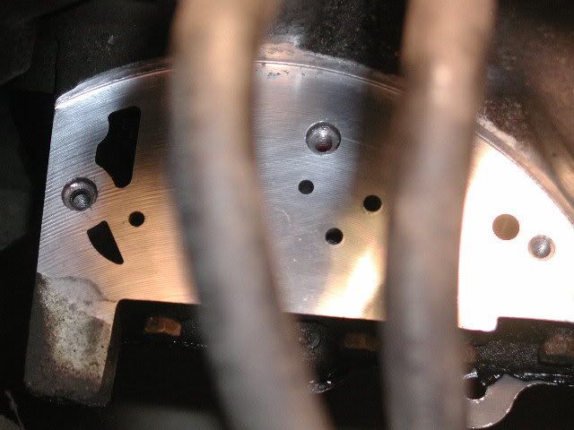

This is what the top of the trans looks like that you mount the bottom of the slenoid to (gasket inbetween) Keep this area clean This is what the bottom of the solinoid looks like
