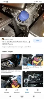

What's the filter mounting position? Base up, base down, vertical, angled, horizontal ... ???
Right on top. Threads down. Here is a pic from the internet.

I've had that happen too Chris. In the lady's 98 Camry. Pull the filter off and zeronoil comes out. And it's set in a fashion like yours. Other filters have had oil come out ofthem when removed from the block.
The Grand Marquis in my sig does it, but it's the chain tensioners leaking on mine, multiple filters haven't helped. Cranking for 15-20 seconds with the go pedal floored helps, though!
Interesting, on several cars I have owned with downward facing oil filters the filters all drained oil out if removed soon after the engine is stopped, and all were bone dry if left for several hours or overnight. I almost always let it drain all night. Bone dry. The oil is still behind the adbv but whatever could make it’s way out the center hole, did. All had small catch basins for the oil under the filter. The Maxima even had a tube from the catch basin so the oil would come out below. Never ever saw any difference between filters, and the Toyota ones acted the same as the Ultra, Boss, and others.
