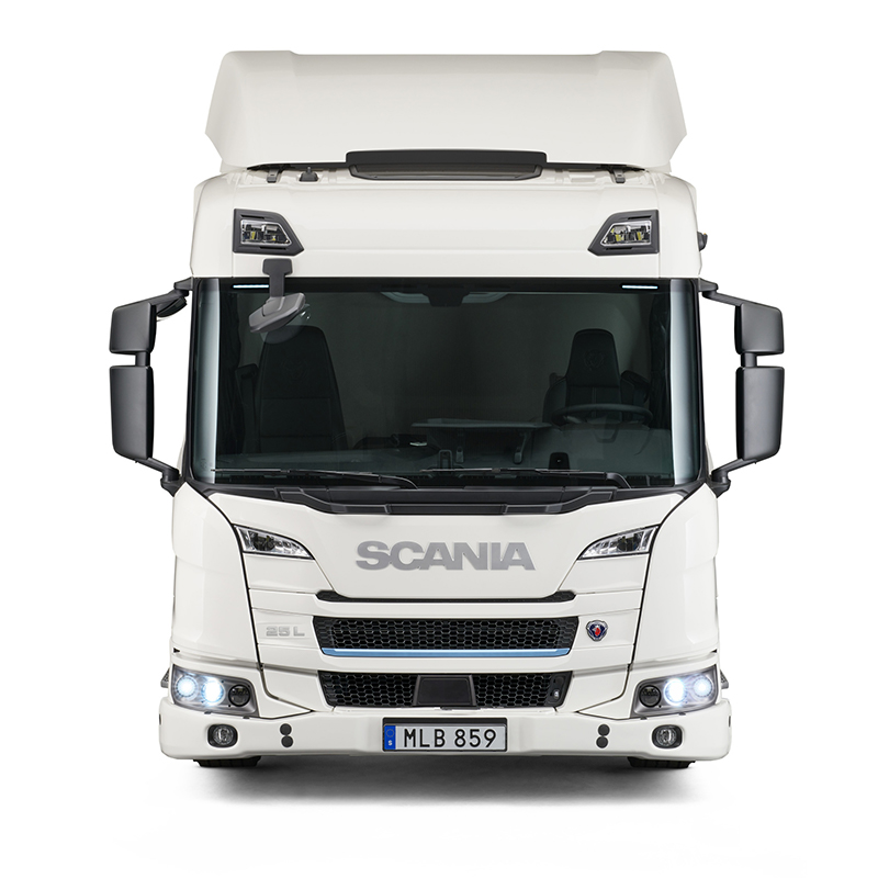

This is interesting:
BATTERY CAPACITY
624 kWh (Installed), 468 kWh (usable) with 75% SOC – Up to 350 km range at 40 t GTW and 250 km range at 64 t GTW
CHARGING
CCS2 375 kW / 500 A DC
Fully charged in less than 90 min at 375 kW
GTW
Max 64 t
should give you an idea of battery capacity needed to get 800 km range as the tesla truck does....
and from another site about the scania truck:
At the time, Scania told electrive that the vehicle itself weighs 10.8 tonnes – around 1.5 tonnes more than its diesel counterpart. Among other things, this is due to the nine battery packs installed, which have a total energy content of around 300 kWh.
but that's for just over 1/3rd the range and half the power. More power means more bulky mechanicals and more range means more battery.
I still stand by my 5 tonnes heavier than ICE with the range and power as stated
