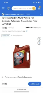

-What Maxlife ATF from Walmart can be used on this Civic?
-What coolant does it take? IIRC was it the blue one??
If this is someone else's car and you're taking "responsibility" like this, I'd only use Honda DW-1 ATF. You can get it for about $8/quart and that thing only uses 2.5 quarts on a drain and refill.

You don’t think the Maxlife would be good in the Civic? It’s only 3 quarts so maybe we’ll have to go to the Honda dealership. I’ve been using it in our 3 Pontiac Vibes at every 30k and no issues, but these are Toyota transmissions… I agree with the NGK & Denso iridium plugs for sure and never order them from Amazon. There’s a lot of counterfeit parts nowadays. Also, yes! These 2 brothers actually want to learn how to do this stuff! Hopefully they can get their cousin’s into it since I can’t 😂😭
Plenty of people will tell you it will be fine 🤷‍♂️ A popular theme here for justifying things is "it's cheap insurance" but it seems to get picked and chosen as to where it applies. Sure, I can buy a 4-5 quart jug of Maxlife for $20 ($4 or $5 per quart) or tighten the budget by spending .... $24-30 on DW-1. I'll go with DW-1. 😁

I use Idemitsu DW-1 equivalent, Maxlife and DW-1. All good.

I use the Castrol Import ATF on my Hondas with no problem. Never tried Maxlife though.
I never noticed (or looked, I guess) that Castrol specs that fluid for DW-1 applications. I figured Z-1 though and they'd want you to use the next-gen ATF, Transmax Full Synthetic, for DW-1.

- MaxLife ATF is fine; 5w-30 oil is fine; Asian blue or universal (yellow) coolant is fine
