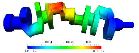

I'm not the best person to explain things. I got some pix from online. I hope this helps. Endplay: Deflection:

Even if it is end play justinbaileym, I wouldn't be to concerned about it. Inline engines can take more endplay than a "V" configured engine. Some might tell you horror stories about connecting rods smashing into the crankshaft weights, but on your Saturn, I would not worry about it at all. Particularly if a thicker oil reduces symptoms. You have plenty of life left in that car, even at 160,000 miles.
