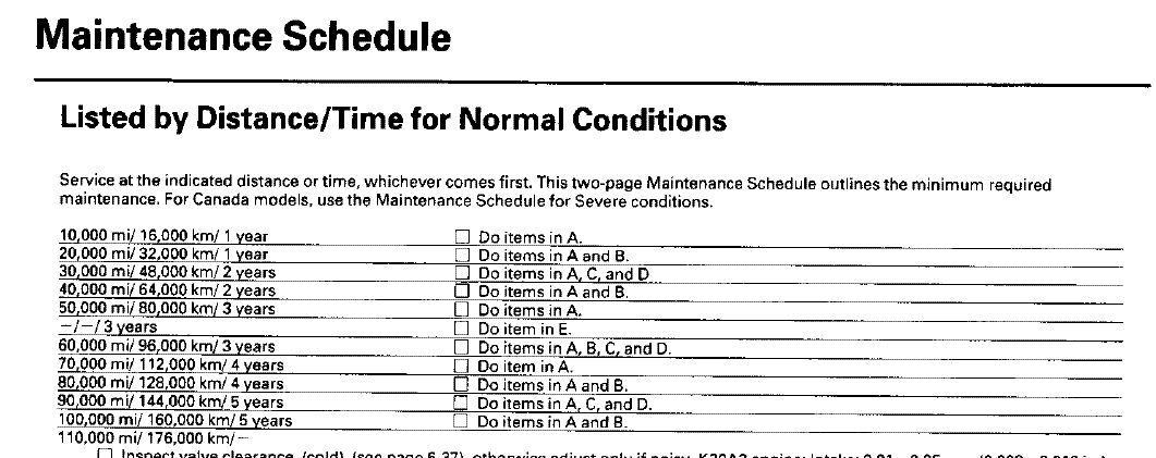

I have a 2005 Honda Civic 1.7 with Pennzoil Platinum 5w-20 in there right now. I'm at about 5k on the oil and just checked it out. Now I've read around here that oil color really cannot distinguish whether the oil is good or not. I understand that even if the oil is black that doesn't mean its done. My question is in the 5k I've had it in there, the oil is between the amber color and black, like a brownish leading me to bleieve the oil is still pretty clean. Anyway, how does that sound and should I extend my OCI? The manual calls for 10k on normal service and that is on dino. I don't think I would run dino that long even on the manual recommendation, but for syn like Pennzoil Platinum?

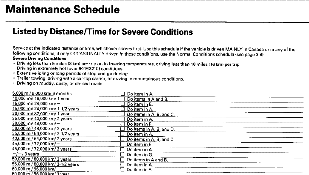

it does, 5k for severe service. This was right before they put the OLM in the Honda's.
Belt driven Honda motor is NO PROBLEM with 10k on todays conventional.

Ok, more serious. You can run *any* 5w-20/5w30 SL/SM oil for 10,000 miles *if* your usage is not severe. Check the manual and see if your operation would be considered severe. If you are severe (most of us are) then a simple 5k run will be fine. Your engine will last with either syn or conventional, you'll just spend more $$ with one type of oil.

I'd use the severe [5,000] schedule.
