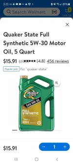

Somebody earlier posted this simple equation for formulating a realistic OCI;
crankcase oil capacity x50 x average mpg. For example my 2018 Ford Edge 3.5 holds 6 quarts and gets ~26 average mpg. = 7800 miles OCI. Engine oil life monitor will run to about 10K miles which I think is too far.
*Interesting tool to play around with to get a realistic OCI - curious how each part of the equation fits together to obtain a realistic OCI ?
Qs
