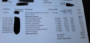

Hello from Greece. We've made a huge research for the 1 NR FE in order to find a solution the past 6 years. We have writen everything in this forum https://forum.4troxoi.gr/topic/90795/node-90795
Also this guy explains very well the problem.
TOYOTA also has a tsb that informs for the problem solution.
We have done a lot of tests. Only one solutions is working. To clean the pistons from the upper side in order to clean from carbon the top 2 rings.
With engine flush you only clean the third ring and there is no results. Also with different oil viscocity, you create greater problems, and the engine is rattling. The only correct viscocity is 0-20 for this engine.
The cleaning procedure that worked and from oil consumption of 7,5l per 5000km gone to 600ml per 5000km, was spraying from sparks holes cleaning fluid (very lube - xado anti-carbon engine cleaner). This should be done with a specific procedure.
Do your own research, there are solutions for 1 NR FE.
