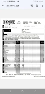

The filters should catch any of these big particles before the engine sees them, however, my last oil sample came back with high silicon levels, nothing was changed prior to that sample and the engine is brand new, is it possible the oil is dirty out of the bucket?
