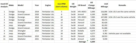

Using the BITOG search engine I was able to find 9 UOAs plus 2 from OhioTech above. Thank you OhioTech for sharing your UOA history.
I've started a data table selecting UOAs that were done with approximately 5,000-10,000 miles on the oil and all have the Pentastar 3.6 V6. I then sorted the data by Iron PPM in ascending order. I want to emphasize this is only a start, more than 11 data points are needed to draw any conclusions.
So far the UAOs with the least Iron PPM were with 5W20 oil versus the later 0W20. The table can use more UOAs especially from later model vehicles using 0w20. Please continue to share and I'll add them. Thank you!

This is because there is more VII additive in the 0W-20 with a thinner base stock typically - that hurts HTFS - and so valvetrain, timing chains, and ring/liner interfaces where full temporary shear occurs, will have higher wear rates.
Finding a 0W-20 with a relatively high HTFS and relatively low HTHS will probably optimize economy and minimize wear.
Not my UOA btw, that belongs to @wwillson!
There is nothing wrong with your 21 PPM Iron. Newer engines shed more iron. Your Fe will come down, it probably already has as you have no lab results from the first 20,000 miles. There really are to many hidden variables to place much value in the data you are collecting. Your sample looks great.

Great worksheet. Smart and succinct. Thanks, much.
