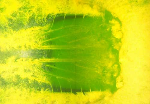

I've settled on 35psi also for 195/60/15 tires. Way better gas mileage and improved handling. I remember reading in motor trend advice from a tire guy saying that it was better to over inflate than be even 1psi under recommended. They showed the footprint of a tire driving over plexiglass in the snow. The tire with higher psi made full contact all the way across, while the slightly lower psi tire had areas of less tread contact.
