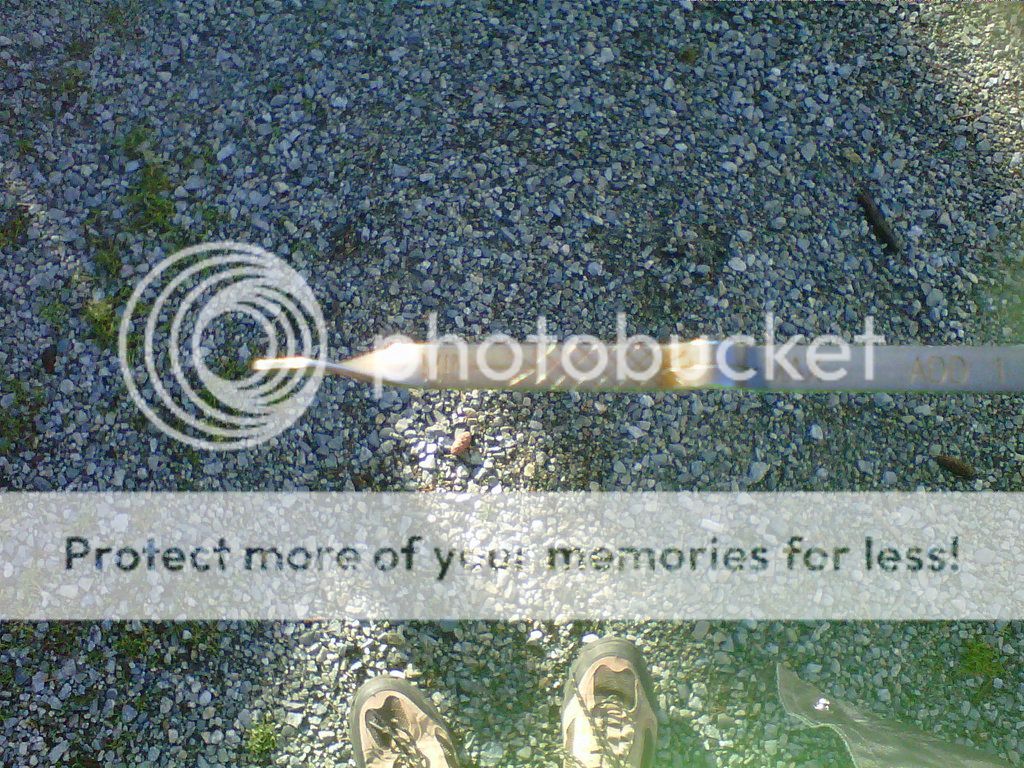

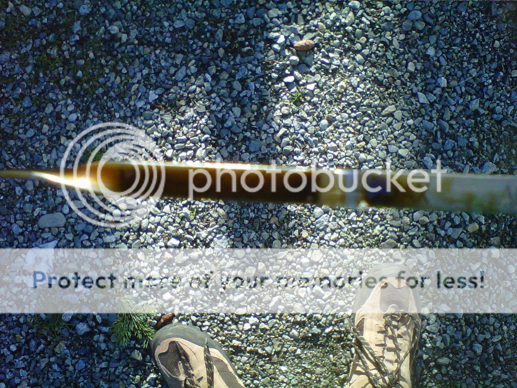

On my grand caravan I recently switched to full synthetic. Currently 147000 miles on it. I know my van consumes a bit of oil between changes so this is not what I expected.
Current fill is Pennzoil Platinum 5w30 with 1600 miles on it. This oil seemed to darken faster than conventional. Most notable color change happened a week ago. Coincidentally the level went up. Only thing I can think of was when I went for a long weekend drive. Did I just release a bunch of sludge?
I'm also considering headgasket problems but I haven't seen any signs of trouble yet.
No odd tailpipe smoke.
No unusual smell in the oil or coolant.
Vehicle runs good and no overheating.
Lots of short trips during the week. Long trips on the weekend. I can't smell any fuel in the oil. At least not that my nose can pick up.

How much oil did you put in the crankcase? It appears to overfilled by about 1 quart. I wouldn't worry, I'm sure your engine will use a bit of oil. Maybe the new oil is doing a bit more cleaning. Just keep an eye on it.
What's happening is the dipstick tube is wiping one side of the dipstick and depositing that oil onto the other side of the dipstick; creating the illusion of rising oil.
I think this is it..
To me it looks like you didnt wipe the dipstick once and reinsert and remove it again.
