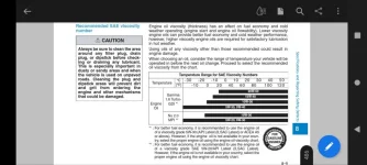

I am in Vermont with lots of mountain driving and it got pretty hot here last summer 96f/35c, I want an opinion if 5w-30 would be better suited for the Kona vs 5w-20, the manual states that between 5w-20 and 10w-30 can be used. I know I am overthinking this, but just want to hear some opinions.
I am using 5w-30 Pennzoil Platinum in my 2.0 in an Elantra right now. I have also used 10w-30 Cheveron Supreme in summer and 5w-20 PUP in Winter. I have not noticed much difference in mileage or performance. No oil consumption at 33k. If I had one oil to choose it would be 5w-30 like I am running now. Covers all the bases.
Looks like 5w-20, 5w-30, and 10w-30 are all recommended for well above your expected summer temperatures, so I would focus on the expected winter temperatures. If you expect temps below 0*F, I wouldn't bother with running 10w-30 to make your life easier.
If you ever need to stop in and grab an extra quart of oil somewhere, you're more likely to find a 5w-20 or 5w-30.
Since your 2.0 engine does not require any special manufacturer certs outside of the latest API/ILSAC approved oils, I would just run your favorite brand of Dexos1 Gen2 approved 5w-30, unless you are more interested in saving maybe 0.5mpg with a 5w-20.
For anyone that can't decide between a 5w-20 and 5w-30, I suggest 5w-30 Pennzoil Platinum. It's on the thinner end of the 5w-30 grade and has great base stocks.
Thanks everyone for the replies, I will prob go with 5w-30 for this next oc which will be a spring summer fill, yay obsessing over oci's and oil grade. I had just got 5w20 pup but the brain did the thing.
