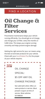

Well, I can guarantee you that on the receipt it says “change in 5000 miles”. That’s just what these quick lube places do.
Update: here’s a screenshot of the Brakes Plus website. Still not a user fail? :)

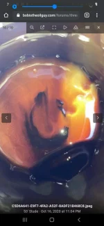

Just another thought about the hole in the media. I’ve seen an experiment that showed a paper filter will go into a bypass mode even before 5k. Yes, it’s a limited experiment with an entry level Mann filter, I understand. My point is, this poor guy probably was in the bypass mode anyway so that teared paper hasn’t changed much IMO
What experiment is that? Link?
I’ve seen a few videos by Russian folks, 2 independent bloggers did pretty much the same with similar results. He’s the first one, I’ll send you another one if I find it, it’s been a while
I can honestly say this is the first non OE interval filter I’ve seen.
Too bad the video couldn't be translated. The 2nd filter they tested was a used one they pulled out of the old filter barrel, and it was sludged up pretty bad as shown when they cut it open, so it's no wonder the bypass valve stayed open most of the time, even after the oil was warm/hot.
Member Jim Allen did a similar bypass valve test (with a delta-p sensor at the filter mount) on one of his vehicles and with various oil filters, and found the once the oil warmed up the filter wouldn't go into bypass. Of course if a filter was super loaded up with debris and sludge that would be a different story.
