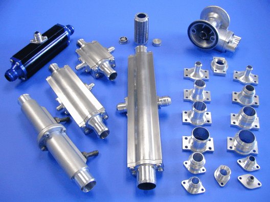

My next move, on admittedly less exotic and far less potent alloy, will be to adapt three exchangers. One sandwich from a Ford/Mopar and two from the Crown Vic rad hose type. One upper and one lower. Then a thermostat to my mega canister ..perhaps without the filter in it and use it as a reserve sump (about 4.5 quarts capacity)..and maybe even a rad type added in for good measure. I have a 180 Permacool collecting dust. Everything should be balanced out nicely with heat being shunted wherever there's a vacancy.

If you really want to balance out your system nicely, you may want to look into something like this:
The excess heat will go wherever there's a vacancy...which would be your aux cooler above 180F
