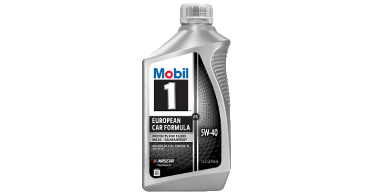

No MObil 1 0w-40 at my Walmart. is 5w-40 Mobil1 just as good?
I heard on this website the 0w-40 Euro has a partularily good base stock better than 5w-40.
But that wa s acouple yeas ago and I know how things cnhange....
It is good but compare the approvals to satisfy you concern.
They appear to be the same.
Both of them have ACEA A3 which is the only one I look for.
I suspect 5w-40 will be just fine in vyehicles (I live in Florida) but I like ot get value for my money and if 0w-40 has the btter base stock I would like to stick with it.

The SP formulations are different, obviously, mainly for DI LSPI concerns. And also, to state the obvious yet again, there are differences between the two simply based on the characteristics (base stocks and VIIs) which achieve the targeted vis.

Mobil 1 5w40 Euro is LL01 rated.

Why would you mix them? That won't get you anything of an advantage. Neither will alternating the two products.
And it's not a 0W weight, the winter rating is essentially a performance specification. But unless you anticipate starting below about -35F then the oil with the 5W rating is acceptable.
If it were my BMW I would not hesitate to use the 0W-40 from Walmart despite not having BMW LL-01 approval. It does have a Mercedes-Benz and a Porsche approval which are both demanding approvals.

You have the N20(N26) so I would not have an issue with M1 0w40. The marketing for the current flavor of M1 0w40 states that the product exceeds the requirements of API SP. So you at least know that it could pass the TGDI timing chain wear test under API. The BMW N20(N26) had timing chain problems for years.
Perhaps in the near future M1 will update their 0w40 with LL01 like Castrol did last year (0w40 and 0w30 are both LL01)
LL01 has a specific N20 timing chain test. I would stick to LL01-approved oil.
Castrol Edge 0W30 is now IMO the best option, however, not the cheapest.
