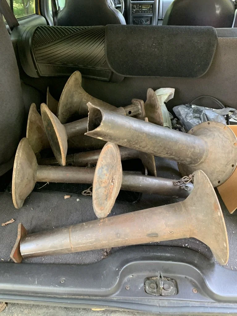

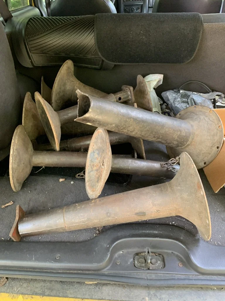

I think cool. I have some really old vintage homemade jackstands. Made in the 1960s by a local mechanic here in town. I bought them from his daughters at his estate sale they sold me everything in the garage minus the lathe. There is different heights all are the pin style. Made from Model T Ford axle housings. If anyone is interested I’ll try and take a picture of them tomorrow some are not complete but still they work. Very sturdy. I trust Harbor Freight for jacks but definitely not the stands. I’ve used their jacks for a couple years now since I started in school both the Daytona and Pittsburgh and they are excellent jacks.

I would like to see your homemade jack stands. I'll post my homemade ramps if you post your jack stands.
Here you go. I found some old pics of them from back in the summer so I added them to my album here. 🙂
