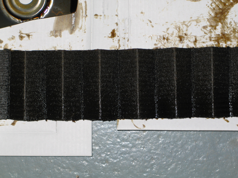

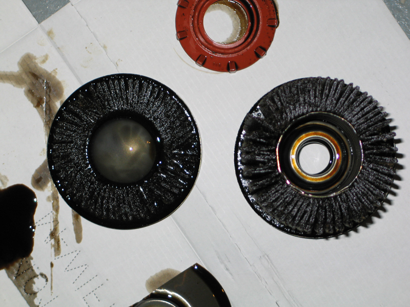

Here are the pics of the Motorcraft filter that came off the Expedition. Mileage on the truck was 162,000Km, OCI was 10,000Km, oil was Mobil 1 5w20.

The distortions are probably from the can opening process. Note the pleats are pretty uniform everywhere else but where he took the image. No breaches ..no goo (would be there if water was present - sorta like a glaze). Looks okay to me Cut up and stretch out the media. If you've got a can of brake clean you can spare, just wash down the media. It shouldn't remove any embedded material, but it will clean the stained media.
Almost every filter I've cut open with the exception of the K&N had the pleat distortions in one spot. Doesn't bother me, but I did intentionally take a picture of them. The rest of the media is uniform. As you can see, the distortion is where they glue the pleats together. Yes, it is DARK. I do not have a can of brake clean unfortunately. It seems to have done some good cleaning, as it appears there is junk in the bottom of the can as well. We'll see how the Fleetguard looks with the TDT next.....

Nice pics, thanks for posting them. FWIW, I agree with Gary, doesn't look too bad. With exception of the distortion in the one pleat, looks ok. 6200 miles, about what I'd expect. Doesn't do anything to change my opinion of MC as a lot of filter for the money. Maybe you can do what GA said and dissect it a little more. Curious if this vehicle has an OLM, or you just chose 10K? What was the time period?
There usually is more of a spacing at the pleat seam. Oddly, it's usually more pronounced on Champ Lab filters. They have a human doing the joining and the figures get in the way.
Definitely a fantastic filter and worth what I paid for it. The Fleetguard that replaced it better hope it's twice the filter, because it was twice the money ;\) I already feel that the TDT is doing some cleaning. Truck seems to be picking up power the more I drive it. I'm going to pull the dipstick tomorrow and see what the oil looks like, I imagine it is quite dirty already. The 10-micron media in the Fleetguard may be an interesting twist, since it should theoretically catch more junk......

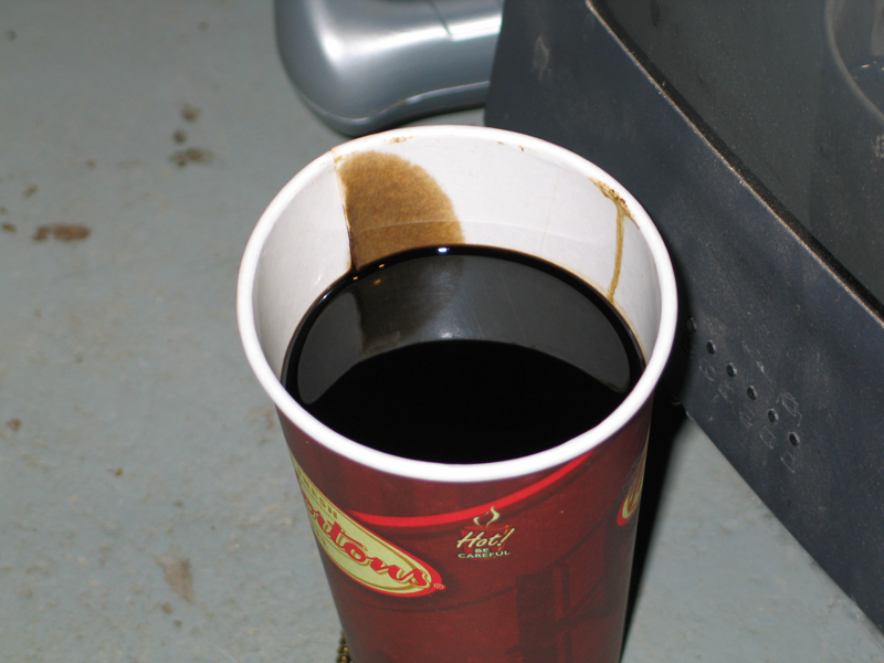

OK, cut the media out and took it apart. I am going to say this: There was nothing added to this oil, it is just regular M1 5w20 off the shelf at Walmart. But these pictures resemble ones I see posted about runs with AutoRX...... This is the oil out of the filter: And here is the media: When I ran my finger down one of the pleats, this is what came off: Looks to be hard carbon deposits.
