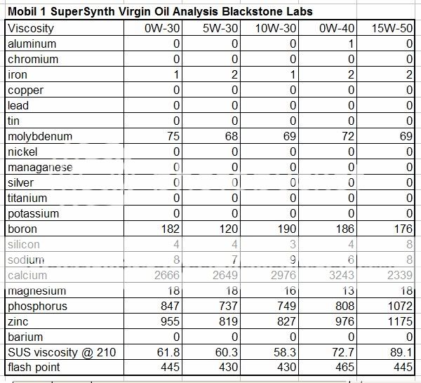

Searching the VOA forum on BITOG, this is the newest info I could find - it's from 2014.
https://www.bobistheoilguy.com/forums/ubbthreads.php/topics/3439699/mobil1-blackstone#Post3439699
[Linked Image from img78.photobucket.com]
Not what you're showing for the Mobil 15W-50 synthetic ... close in some aspects, but not the same numbers.
Only way to know for sure what Mobil 1 15W-50 is today is to find a very recent official sourced VOA, or have a new VOA done.
