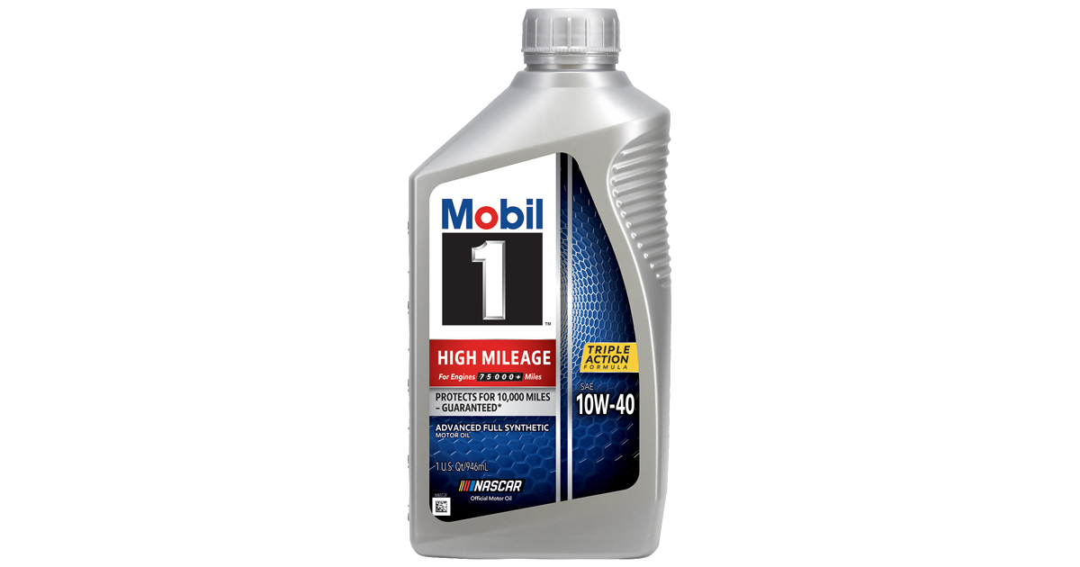

hey good afternoon,
I did look at oils and did see a mobil 1 high mileage 10w40 synthetic rated for gasoline engine. wonder what would happen if i put this in a 1990 toyota corrolla diesel engine?the price looks economical for full synthetic
thanks

FWIW The oil needs to be “C” rated for diesels. “S” oils are for traditional gasoline engines. The C is for compression and S for spark.
Interesting these oils do appear to carry a C and S rating.

i wonder which oil would offer more benefits for my 1990 toyota corolla diesel engine:
1) the mobil high mileage 10w50 full syntethic
2) mobil delvac mx f2 15w40 mineral oil? not synthetic i think rated api ci-4 plus

10w-40 won't have much if any PAO in it because it doesn't need it for the 10W-xx Winter rating. Looks like it is mostly GTL:
The rest is PROBABLY Group III, but could also be their Group II+ EHC, PAO...etc (the latter being unlikely). They can pick and choose what gets called out on an SDS and they've been making them more vague lately.

i see that 40 to 50% of the ingredients get comprised of DISTILLATES, HEAVY, C18-50 - BRANCHED, CYCLIC AND LINEAR cas 848301-69-9 . does that ingredient qualify as base oil group 3 or 4? i looked up gtl and it appears to get classified as an base oil group 3. so mobil one 1 high mileage full synthetic 10w40 has roughly 50 % group 3 base oil and probably no PAO and rest group 2 base oil perhaps. Does the ingredient cas 848301-69-9 equal GTL?

Yes, CAS 848301-69-9 is Shell's GTL base oil family. It's technically classified as a Group III product but has its own CAS # and is unofficially called a "Group III+" because of its performance.
