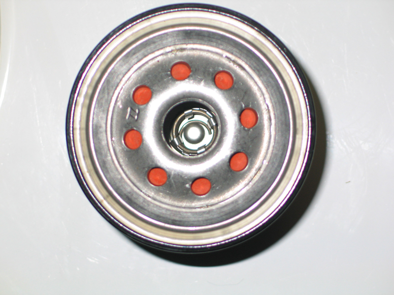

Went to Canadian Tire to grab a fuse for the Expedition (don't play with amplifier wiring when your son is bopping about the vehicle like a rabbit with a cocaine addiction) and noticed they had one of these on the shelf.... Only one... It was lonely. It needed a home. And it is now comfortably at home in my filter stash.
Still not the "perfect" modular filter. Which would have a threaded-end ADBV. But definitely more threads on the base plate than the PureONE or Motorcraft filters I have.
And of course the pics:

used to use these before i learned that ford like their own placement of the valve
They do. Hence my mentioning of it in the original post. This filter would be better with the "right" bypass valve for this application.

Afaik, some M1 applications do have thread end bypass. Guess like some Motorcraft filters, it must be application# specific.
This one here is actually the only M1 I've ever seen that didn't have a thread end bypass.

Sort of my point. There are a couple of applications where Ford has gone out of their way to spec a silicone ADBV and threaded-end bypass. This is one of those applications. The old FL-1A has neither (what my 302 takes) but the M1 filter for that application has both, LOL! Most other filters for that application mirror Ford's design however: Dome-end bypass, nitrile ADBV. Whilst EVERY other version of THIS filter, aside from Ford's own that I can find has the dome-end bypass. It is that fact (the seeming uniqueness of this scenario) that strikes me as odd.
Ya I see what you're getting at and I agree. Why an application that specs threaded-end bypass doesn't have it while most other M1s do is odd. Is there a different application for this filter that does specs a dome-end?

Nope. The FL-820S is the "Modular" filter. Silcone ADBV, threaded-end bypass. The former to prevent tensioner bleed-down and eliminate start-up noise, the latter I assume because of the massive oil volume the pumps in these engines move, which on a cold engine, likely puts the filter into bypass.
