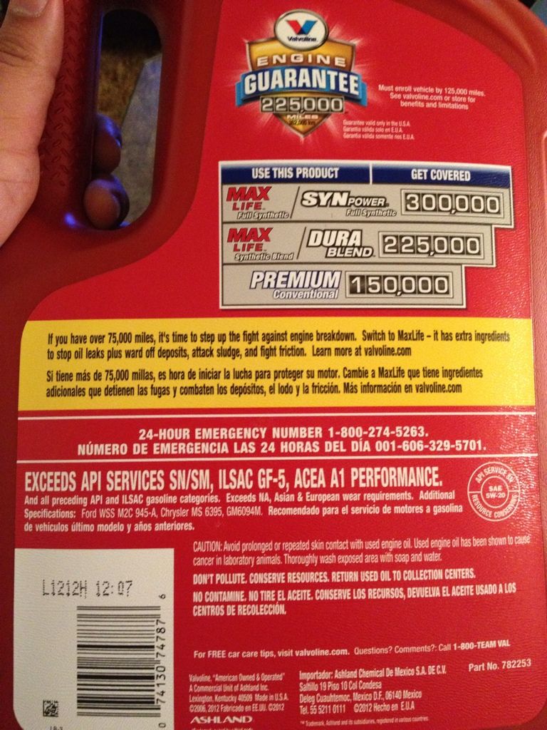

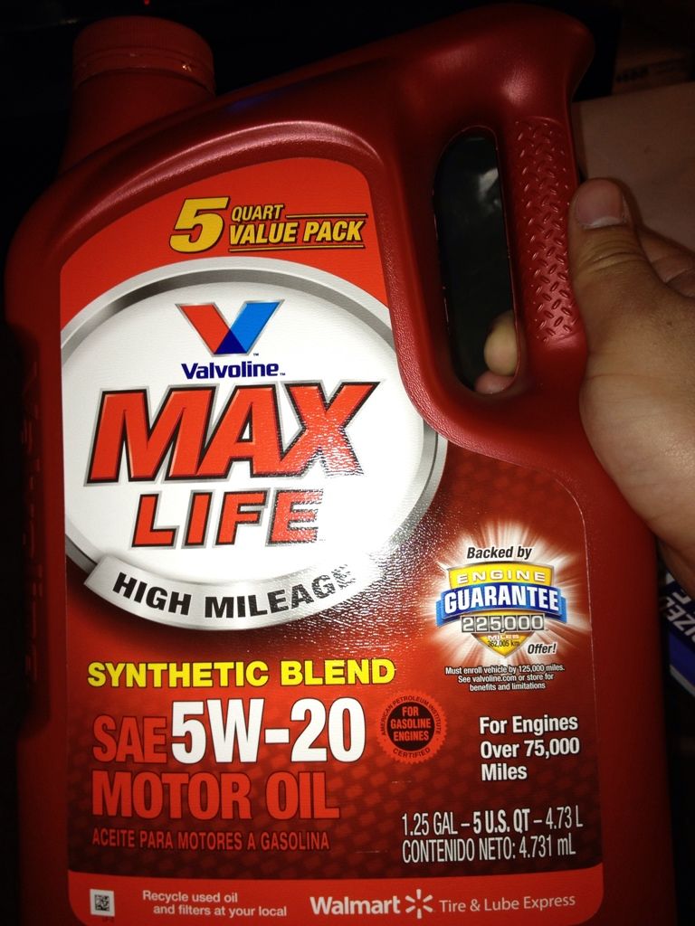

I purchased a 5-qt container of Maxlife 5w20 tonight and noticed that it carries the starburst donut.
Previously, Maxlife did not have this designation since it was not resource conserving. Apparently, the formulation has changed to allow the oil to gain this designation.
I do believe that this change is only on recent batches; the container I received was probably packaged in December.
With the latest development, this makes Maxlife to be a suitable oil for vehicles under manufacturer's warranty. Previously, one should not be encouraged to use this oil in vehicle's under warranty since it did not meet all of the manufacturer's required specifications.
Only A1 which is the lower of the two low HTHS Acea specs, I assume this is a synth blend or semi synth?
They might have a product soon for the EU market, lots of newer vehicles need these low HTHS oils but in 5w30 or 0w30.
Perhaps that's why it says "SYNTHETIC BLEND" in bright yellow letters on the front of the bottle?
This change happened around august of last year. Its just finally trickling down the chain into retail markets now. We've been using this at the shop for a while now , excellent oil, runs smooth and cleans well.

is the starburst on all the varieties or just 5w20?
The starburst is also on the NextGen Maxlife Syn Blend 5w30. I'd imagine Valvoline also upgrade their regular Maxlife Syn Blend 5w30.
