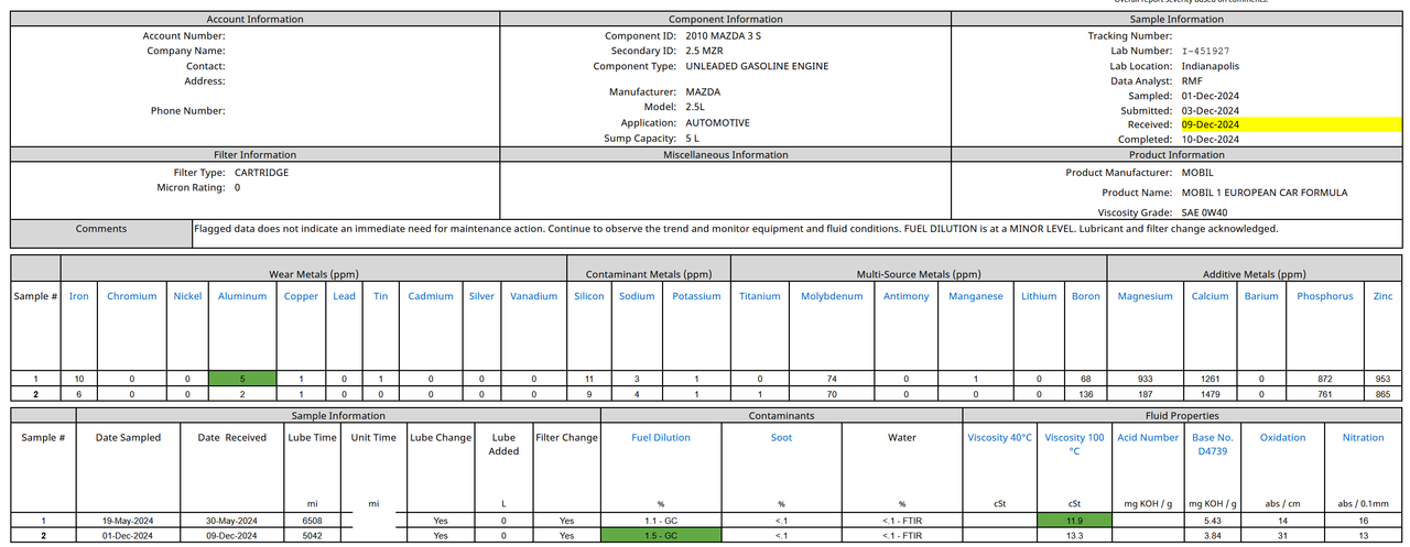

Sample 1 is FS 0W-40 (visc low from residual 0W-20). Sample 2 is ESP X3 0W-40. 5k miles but a lot of idle time and traffic. Looking good, TBN a little low but didn't do VOA so it might start low. Held viscosity really well. Removed unit time because it's wrong.
I'm Curious if anyone's done a VOA on the x4?
I don't think so, I probably should have but I only had one test kit left on hand. I'm mostly just doing this for fun since a 150k mile Mazda 3 with 2.5 MZR engine doesn't really need Porsche oil either but why not.
