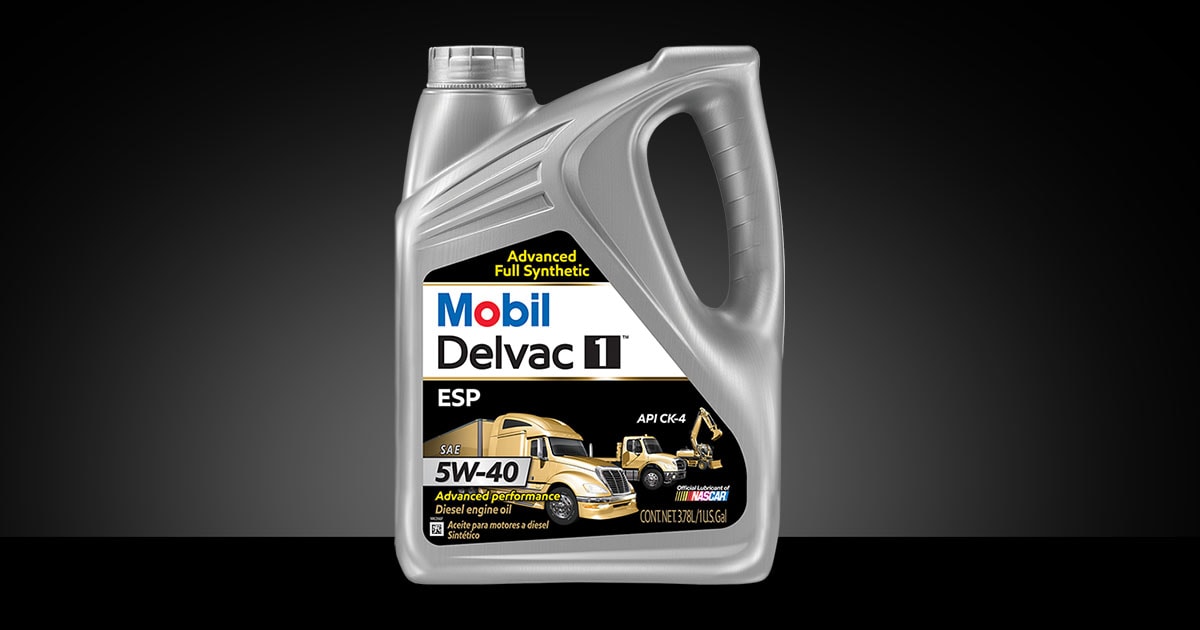

It’s likely the HTHS of the new 0W-40 FS SP is higher than 3.6. The 14.1 cSt ESP X3 is 3.8 in the PDS. Different product though so probably best to ask Mobil.
