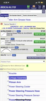

wwilson: Thanks for posting on this including the information on the rvths site. I am dealing with the same issue on my 2021 3500HD. The 3 zerk fittings on the: idler arm pivot; Idler arm to center link; and the pitman arm to center link are a pain to access.
Did you end up installing one of the extension hoses? Looks like Moog and AC Delco both make these. Maybe the same item. I see that Amazon also carries the Moog.
Good to find out the threads are all 1/4 28.
No, I just installed a 90° zerk in the upper idler arm pivot and remove the splash shield to grease it. Removing the shield takes about 30 seconds with a socket on an electric drill.
