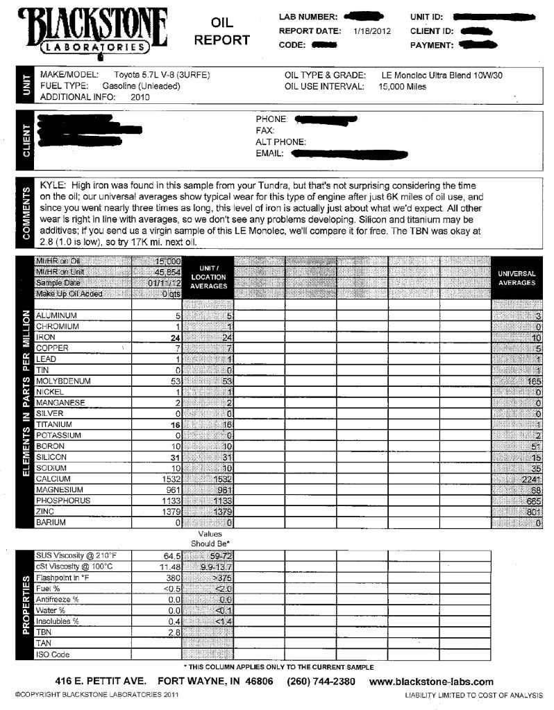

Wow, nice report considering the miles. I'd take Blackstone up on that offer and send in a virgin sample of the oil to get more data, esp since they're doing it for free and you give have to pay postage costs.
I've been using this oil in a few vehicles for several years. I haven't paid much attention to the Toyota 5.7L engine, but here is a report from my 09 RAV4: http://www.bobistheoilguy.com/forums/ubb...rue#Post2282436 Here are some reports from my 4.7L Tundra engine that has a VOA included: http://www.bobistheoilguy.com/forums/ubb...rue#Post1933689 The batch of LE 8130 that you used could very easily be somewhat different than the one I tested. But I suspect that the high Si level is either from residual assembly lube, castings, or dirt. The Fe levels are a little high IMO. Do you know what might be made of Ti in your engine? This was a nice long run, but I would want more information on a UOA if I went this long. Did you refill with 8130?

On a completely separate note, I'd just like to say these are VERY impressive results for 15k. Monolec is a very impressive oil!
As for the UOA here; looks decent. I'd say worthy of further use. As for the warranty issue, I'll say this ... I agree with Pablo. What this comes down to is the M/M warranty act. That is legislation that protects the warrantor (and warrantee to some degree). If you follow warranty conditions, then you're covered. No real debate there. The burden of proof is upon the OEM should any issue arise. If you choose to NOT follow warranty conditions, the burden of proof is upon you to prove that your actions did NOT cause the failure of component xyzpdq. If you use a non-approved lube, then the OEM can push the issue to you. I would presume that LE also has a warranty. This is the same as Amsoil and others like RP, RL. If you have a part that fails, and it is a lubricated part, and you use a NON-approved fluid, then I'd turn to the lube OEM for assistance. They can often give some help in the "David/Goliath" war you'd enter. Of course, those lube OEM also have warranty conditions you have to comply with. Great example: GM spec's ATF in the xfer case in my generation of GMT800 trucks. Some people choose to use 5w-30 motor oil rather than ATF. GM isn't going to cover that warranty claim, and would push the burden to you. So, if you use Ammsoil "HDD" in the t-case, and there were to be a failure, then Amsoil would ALSO deny you coverage because their warranty is predicated upon using properly spec'd fluids. (think I'm wrong? go read teh DETAILS of the Amsoil warranty ...) However, if you used Amsoil "ATF" of "ATD" in the t-case, then Amsoil would cover you; that is a properly spec'd fluid application. Amsoil would likely push the burden of proof back to GM, as Amsoil could well prove that their fluid, via testing standards and protocol, would perform "as if" a spec'd fluid. How do I know this? I had a "lemon law" claim against Ford back in 1990. I learned way more than I wanted to know about the M/M act. The legal precedent is that the burden of proof lays with the OEM unless the user shifts that burden to himself or others by using non-spec'd products. Caveot Emptor.

[/color]Obviously not a 800ppm P compliant oil.[color:#66FFFF] Newbie here. Could somebody explain this to me? What is this, and how can you tell the oil is not compliant? I assume this is bad, but the numbers seem pretty good from what little I know. Thanks!
Found this in another forum and think it answers my question, if the poster was correct: "Phosphorus is the key component for valve train protection in an engine, and 1600ppm (parts per million) used to be the standard for phosphorus in engine oil. In 1996 that was dropped to 800ppm and then more recently to 400ppm - a quarter of the original spec. Valvetrains and their components are not especially cheap to replace and this drop in phosphorus content has been a problem for many engines. So why was the level dropped? Money. Next to lead, it's the second most destructive substance to shove through a catalytic converter. The US government mandated a 150,000 mile lifetime on catalytic converters and the quickest way to do that was to drop phosphorus levels and bugger the valvetrain problem. Literally."

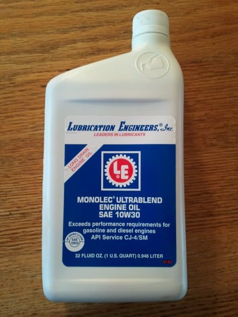

Sorry my 'net was down. Good work on digging. That quote is what I would say is "partially correct". P levels have not been dropped to 400. Just 800. The oil in use definitely exceeds 800 PPM and is not a fully compliant API SM or SN oil.
If you look at the label it is dual marked CJ-4/SM, which is how they are getting away with the extra Phos. Yes, limit for SN is 800ppm, just as it was for SM. I dont know where the FUD that SN dropped it even further came from; but I have seen it all over the place, here, and elsewhere. What SN does do is specify Phos Retention. In otherwords limits the amount that can evaporate out of the oil. So, after use, in theory, an SN oil should have MORE phos left than an identical SM oil in the same use situation.
