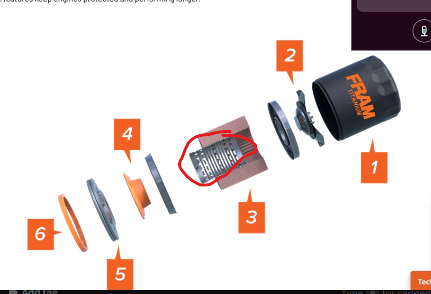

On that site they state the Titanium has synthetic blend media with wire backing, the Endurance (exact duplicate of Royal Purple & Amsoil) has wire backed full synthetic media. I asked Fram if the Titanium had the same wire backed media that the original Ultra had. This was the response:
Apparently so......Bottom line ... the Titanium is going down the same route as the Ultra and doing away with the wire backed media. Just like the Ultra, there may still be some models of the Titanium in the AAP stores that still have the wire backed media. Bring your strong LED flashlight to inspect for the wire backing through the center tube is the best way to verify.

I can return the Titaniums at my local CarQuest, but let me ask you this: If I see the wire backing, would that indicate full synthetic? I think those might have louvers as the Amsoil version does, might be hard to see.....
Ya, I like the part where she circled the core & said that is the metal screen that helps capture dirt.......
I think the later days of the wire-backed Ultra was also a synthetic blend based on Fram's website. If the Titaniums have the wire-backed media then it's most likely the same as the Ultras that were wire backed. If the Titanium is wire-baked, then I'd use them.I can return the Titaniums at my local CarQuest, but let me ask you this: If I see the wire backing, would that indicate full synthetic?
