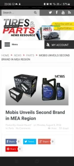

The box from the filter has a fine printing on it that says "Not to be used for warranty repairs" .The online site where I bought it from listed this as a original hyundai filter .
I also just found this Hyundai second brand
First choice after genuine
Product Line 2 was launched specifically for vehicles older than 3 years. This additional product line focuses on wear and tear parts. As these products have been developed directly by the car manufacturer or their genuine suppliers they have the same warranty conditions as genuine parts.
Saving cost, not quality
Product Line 2 parts offer matching quality to genuine parts at a lower price. This price advantage is mainly achieved by different specifications such as modified design and material matched to the requirements of older vehicles or reduced logistic costs. Customers benefit directly from this price difference.
Product Line 2 portfolio
Product Line 2 parts can be easily identified by “S” prefix in the genuine part number. The range of vehicles covered as well as the number of parts included in Product Line 2 is steadily expanding. Product Line 2 parts can be used for regular repairs of wear and tear parts, fitting first time and saving you both time and money."

It's genuine from hyundai, you can read my previous post there is a link In there which explains it.Hyundai link
That is not OEM Hyundai/Kia. It is Mobis.
Yes Mobis is part of Hyundai, but it is not the same filter that the OEM one is.
They are "official" parts for H/K, but not OEM parts. It is a second tier lineup with the backing of the OEM.
Can you compare the one you have with an OEM H.K filter, sure, but they are not the same, as it obvious by your disection.
