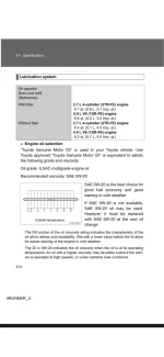

Part of the reason that allows the specing of 0w20 on the Dual VVT-i 1GR-FE, is due to improvements in cooling in the block, and less friction in the valvetrain due to roller rockers, with hydraulic valve lash adjusters. However, the same engine is approved up to 15w40 in Puerto Rico, and 20w50 in the Australian market.
Our 0w20 spec is CAFE and EPA driven.
